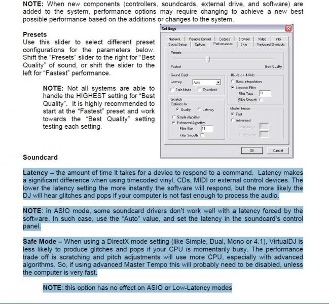

I gave you the best advice based on My own experience, but if you need A TextBook answer then Read your owners manual Page 36 and 37, and Yes leave it Off...
Look here;
geposted Wed 25 May 11 @ 3:44 pm
If my memory serves me right I read that the Safe Mode was to be used for "older" pc's.
How old?? only you can make that judgement call.
