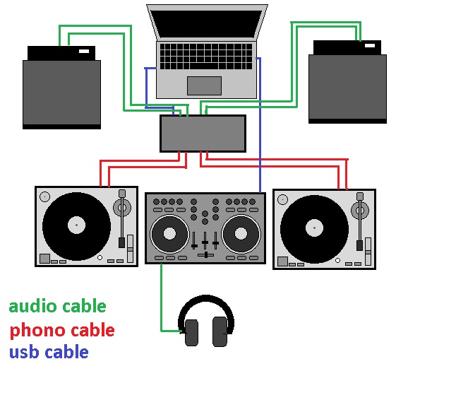

Anyone smarter than me that could draw up a wiring diagram for this using ESI Maya44 card, Mixtrack pro and the turntables?

Ok try this,
Run your turntables into 1/2 & 3/4 on the Maya 44.
Now open the advanced config and set it up like this,
Timecode 1 - Maya 44 - Input 1/2
Timecode 2 - Maya 44 - Input 3/4
Master - Mixtrack Pro - Output 1/2
Headphones - Mixtrack Pro - Output 3/4
I've never used a Pro but that seems like it should work out. Try it and let me know.
Huey

here you go champ, although come to think of it, i'm pretty sure the mixtrack doesn't use asio dirvers, so you probably cant have the two soundcards operating together, in that case just route the headphones through your laptop soundcard using advanced config

Numark site says the asio4all drivers can be used with the mixtrack pro. Also, the maya44 card says it has a separate headphone jack. I could that too for the que right?
Also, in this setup, where do i ground the turntables?

not too sure if the maya has a built in preamp actually, I have never used one, if it doesn't you will need a phono preamp, probably the cheapest option for this is to get a secondhand mixer that has one built in, I got a stanton sc3 about a year ago for $5 of ebay, but any cheap mixer would do the job, otherwise you should be able to pick up a phono preamp new for about $20-$30
