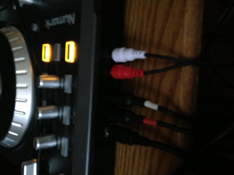

 Back of the controller
       geposted Tue 27 Aug 13 @ 7:03 pm
          The red and white are connected to my main unit for the speakers the black ones is connected to lap top
Which is what I read to do

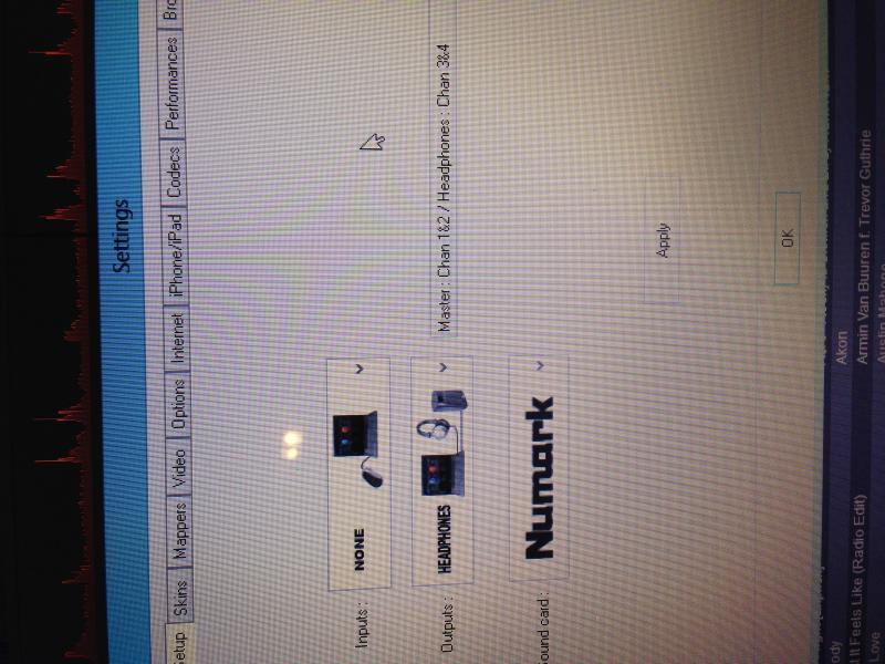

Sound config is on Numark sound card input none output headphones main 1&2 headphones 3&4

Here is how I have my sound set up and I unhooked the RCA from lap top to controller
The only thing left is USB from controller to laptop
RCA from controller to main and STILL no sound unless I turn on laptop speakers

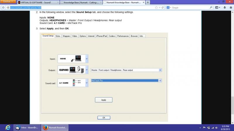

          http://www.numark.com/kb/article/1408
Numarks sound setup looks like this.
geposted Wed 28 Aug 13 @ 4:28 pm
          That looks a lot better, can you get these options in your config?

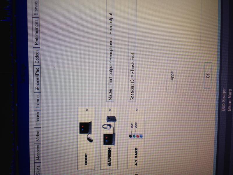

    geposted Wed 28 Aug 13 @ 4:32 pm
Ok here is how it shows for me and that's how I set it
Now here's the weird part the RCA from the controller is the output and I have it going into
the master output on my main unit which is where I hook up my powered speakers
And finally I can turn off the laptop speakers and I now get sound like I'm supposed to
