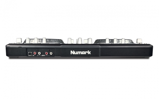

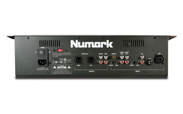

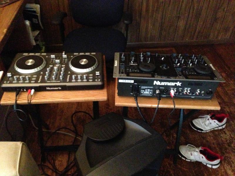

Looks to me that you've got the RCA cable from the Mixtrack Pro connected to the RCA output of the iCDMix - which is wrong.
Never connect outputs to outputs!
The cable from your Mixtrack Pro should either go directly to your (presumably) powered speakers, or to an input of the iCDMix. Either aux, line 1 or line 2 (and ensure that the switches are set to line, not phono).

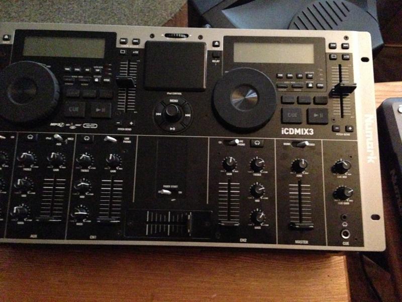

Don't have the option? Yes you do - you just need the correct type of cable.
Assuming the speakers have XLR inputs (guessing again because you haven't said what they are) then you simply use a stereo RCA plug to male XLR cable.
I hope you've read the manual for the iCDMix and realise that the input selection switches on each channel need to be switched to the correct position based on whichever input you're using on the rear of the iCDMix?
For example, if you plug the output of the Mixtrack Pro into the aux socket on the rear of the iCDMix then you need to move the switch on the aux channel (to the left of the mixer, where it says aux) to the aux position in order to hear anything.
You may also need to increase the aux gain control (turn it clockwise) and raise the aux channel fader - oh, and the master output volume.

hwm1992 wrote :
what bugs me the most is why it's working the way it is (out to out)
Well because the iCDMix has outputs on XLR and on RCA, there is an internal connection between the two (because the output signal has to feed both sets of sockets) so the signal from the Mixtrack Pro is simply looping round from the RCA sockets to the XLRs.
The bad thing is that if you play anything on the iCDMix, you'll put a voltage on those output sockets and potentially send that voltage up the Mixtrack's back passage and cause damage. You're also feeding a voltage (the output of the Mixtrack Pro) back into the output of the iCDMix which isn't good either.

hwm1992: Did the setup that you have pictured work at home and your gig?
Had to edit post, took a look again and it's connected to master ouput not input. Should have put on glasses first. LOL
http://www.amazon.com/Hosa-Cable-XRM105-RCA-Male/dp/B000068NZK

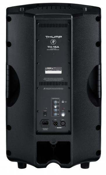

What kind of connections are on the back of your speakers? If they are XLR, something like the post above would work. I highly recommend getting a stand alone mixer. Especially if your going straight from your device to the speakers. The more control of the audio, the less chance of blowing your speakers.

The connections are just like mic cords (male/female)
I'll snap a picture in a few and post
geposted Sat 31 Aug 13 @ 12:01 pm
TearEmUp, here\'s a screenshot of back of his speakers. One other TIP hwm1992, always plug your controller into the same usb port. Also page 6 #7 will show how to correctly set up aux on your icdmix3

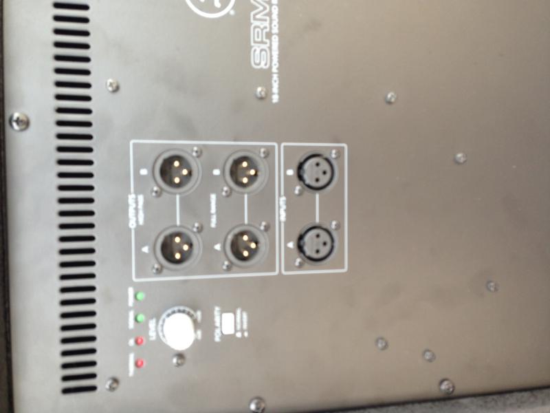

Here is the back of my sub
And yes the only way I've been able to get sound is output to output
Even when I had the sound config done correctly
