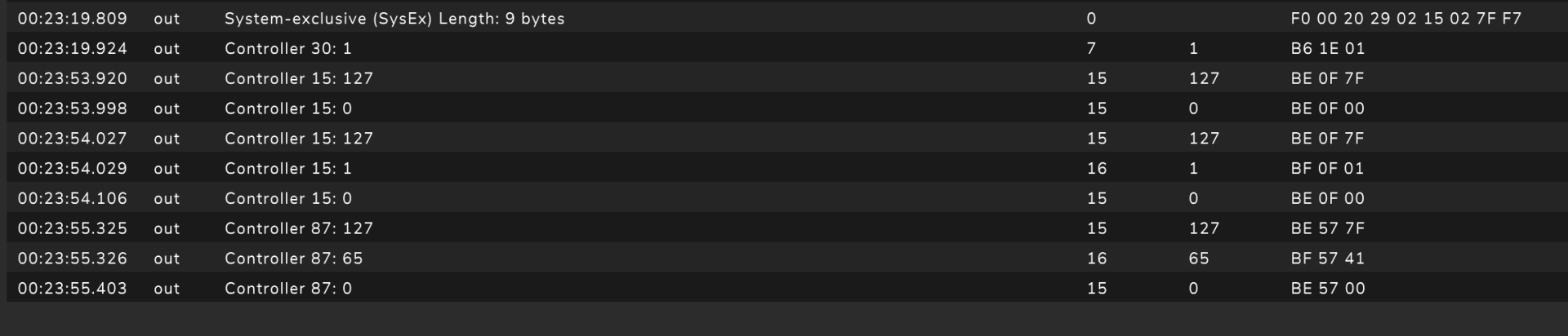

There is for now a little problem with Row A. Even if EncoderRow-A is ticked on Relative mode, the row will be in Absolute mode. B and C rows behave as expected. If I tick Absolute and then Relative after startup, Row A will then be in Relative mode and it will remain correct until I restart. It looks like the command for Row A in Relative mode is not sent or not received correctly on startup.
I also had another issue, peculiar but possibly not important. I had to restart maybe 10 times to get the controller to work. First time it was not recognized ,second it was recognized but no change in behavior, 3rd I think the LED's were wrong but the encoders operated, etc. I think the last step was to have the page arrows light up for the first time. Everything now seems fine after this initialization.
Thanks for the new release, I was able to test and it will be great to use!

geposted Tue 05 May 26 @ 7:47 am
Yes, I'm running the latest firmware.
Yes, I had some custom device and mapper done. They were all moved in different directories.
I removed everything but the USB cable to the Launchcontrol, rebooted, restarted and Row A is still in Absolute mode.
I attach an image of what I see in MidiView while starting up, turning a row A encoder and finally turning a row B encoder. Sysex and Controller 30:1 happen at startup.
geposted Tue 05 May 26 @ 1:11 pm
I will check again, but going from 0 to 127 and back to 0 without any intermediate values is not right either..
You're on a MAC, right ?
Just to be sure, what's the port names of your LCXL3 under MIDI studio ?
VirtualDJ should send A LOT more messages during startup after the SYSEX shown in your screen capture..
geposted Tue 05 May 26 @ 1:46 pm
I'm on Win11,Surface Pro 10. The name in Midiview is "MIDIIN2 (LCXL3 1 MIDI)". Could be that Midiview filters out some Midi? What is your prefered Midi tool in Windows?
geposted Wed 06 May 26 @ 1:26 pm
Never mind. We have identified the root of the issue and we will push an update to fix it.
Just FYI, the message to set the knobs to relative mode was sent before the unit was set fully in DAW mode and this made the unit sometimes to reject it.
With the new mapper update, VirtualDJ will wait for the unit to fully enter DAW mode before it sends the message to switch the knobs to Relative mode.

Also now the mapper "waits" for the controllervar to switch from 0 to "any" other value before sending the message to set the encoders in the desired mode.
This means that if you are going to remap the DAW modes of the unit you need to keep the part of the mapper that sets that controllervar.
This is happening on the keys:
MODE_DAW_MIXER, MODE_DAW_CONTROL, MODE_CUSTOM_01, ... , MODE_CUSTOM_16
You can remap those keys, but you should keep the controllervar '$LCXL3_Mode' 1 part of the mapper.
Of course, other ways to "force" the encoders into a specific mode of operation do exist, in which case all of the above do not really matter anymore.
I will try to think of a nice way to put this info on the device manual as well.
