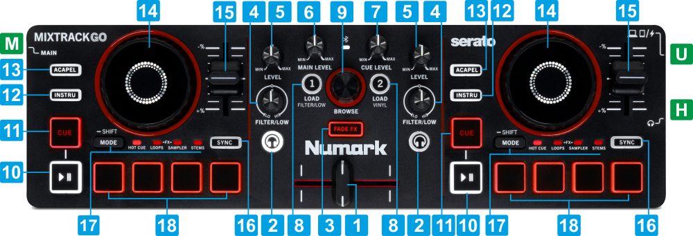

Controls
NAME
CONNECTION
U USB
USB port to connect to a computer
M Master OUTPUT
Connect a pair of amplified speakers using a 1/8 " cable or adapter
H HEADPHONES SOCKET
Connect your Headphones using a 1/8 " cable or adapter
KEY
ACTION
SHIFT ACTION
1 CROSSFADER
Blends audio signals from left and right decks
2 PFL
Sends pre-fader audio signal to the Headphones channel (for pre-listening)
3 FADE FX
Enable/disable the selected Mixer FX. When enabled, an FX will be applied as the crossfader is moved from one side to the other. See MIX FX (Nr.7) in Manual
Select a Mixer FX from the popup list
4 FILTER/EQ-LOW
In Filter mode : adjust the selected Color FX (Filter by default)
In EQ Low mode : adjust the Low EQ frequencies or the selected Stem channel dpeending on the EQ mode See EQ Modes in Manual
5 LEVEL
Adjust the Volume level of Left/Right Deck
6 MAIN LEVEL
Adjust the Volume level of the Master Output
7 Cue LEVEL
Adjust the Volume level of the Headphones Output
8 LOAD
Load the selected track to Left/Right deck.
Double-press fast to clone the Track from the calling Deck to the opposite deck
Left button : Set the Filter/Low knobs to Filter or EQ Low mode on both decks.
Right button : Toggle Vinyl/Scratch mode on both decks
9 BROWSE
Scroll through Folders or Tracks
Push to toggle focus between Folders and Songs List.
When in Folders list, push for more than 1 second to expand/collapse sub-folders
Scroll fast (10 Tracks/Folders on each step) through Folders or Tracks
Push to set focus to Browser's Sideview. When in Sideview, push to cycle through the available lists ( Sidelist , Automix, Karaoke etc)
10 PLAY
Play/Pause Deck
Play-Stutter Deck
11 Cue
Sets current position as Temporary Cue point.
Preview track when paused while button is pressed.Jumps and stops to the Cue point when playing
Jumps to the begiining of the loaded Track
12 INSTRUMENTAL
Outputs only the Instrumental Stems (mute Vocals)
Outputs only the Instrumental Stems by Echoing Out (and mute) the Vocals Stem
13 ACAPELLA
Outputs only the Vocals Stem (mute Instrumental)
Outputs only the Vocals Stem by Echoing Out (and mute) the Instrumental Stem
14 JOG
Touch sensitive jogwheel for Scratch (when Vinyl mode is enabled) or Bend (when Vinyl mode is disabled)I
Fast seek Ihrough the loaded Track
15 PITCH
Adjust track's tempo (BPM)
16 SYNC
Match BPM and Beat Phase with the opposite deck
Smoothly reset Deck's Tempo to its original value
17 SHIFT/MODES
Press to cycle through the Pad modes (Hotcues, Loops , FX, Sampler and Stems ). See Pads
Hold down for more than 1 second to access the SHIFT/secondary actions as describe above
18 PADS 1-4
The 4 numbered Pads offer different functionality depending on the selected Pad mode. See Pads
