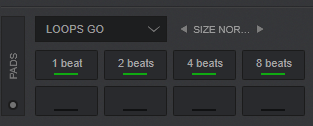

Loops GO
Use the PAD MODE button until the second Led ( Loop ) is lit to set the Pads to Loop mode. The special Loops GO page will be then selected and displayed in the VirtualDJ GUI
Note : The special Loops GO page is only available when the Mixtrack GO is connected
Loops GO Page - VirtualDJ GUI
In this mode, the 4 numbered Pads trigger an auto- Loop of a different size in beats, depending on the selected Loop Size Bank.
3 different Banks are available (Small, Normal and Large) offering Loop sizes from 1/8 to 64 beats. Use the arrow buttons on the Skin to select the next/previous Loop bank

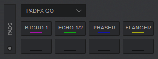

PADFX GO
Use the PAD MODE button (Nr.17) until both the second Led ( Loop ) and the 3rd led (SAMPLER) is lit to set the Pads to PadFX GO mode. The special PadFX GO page will be then selected and displayed in the VirtualDJ GUI
Note : The special PadFX GO page is only available when the Mixtrack GO is connected
PadFX GO Page - VirtualDJ GUI
In this mode, the 4 numbered Pads trigger an Effect as described below. The pads will toggle (enable/disable) the pre-defined FX, but if held for more than 1 second, the FX will be triggered only while the Pad is pressed
  • Pad 1 : BeatGrid FX (pattern 1)
  • Pad 2 : Echo FX 1/2 beat
  • Pad 3 : Phaser FX 16 beats
  • Pad 4 : Flanger FX 8 beats
  • SHIFT+Pad 1 : Loop Roll FX 1/2 beat
  • SHIFT+Pad 2 : Echo Out FX 1 beat
  • SHIFT+Pad 3 : BrakeStartFX
  • SHIFT+Pad 4 : ScaleDownFX
