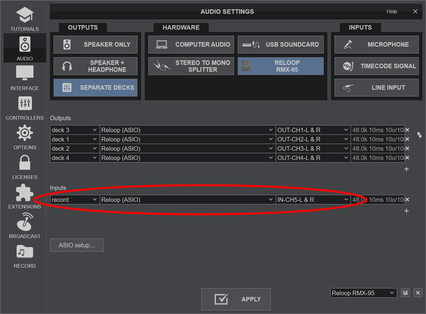

RECORD & BROADCAST
Recording and /or broadcasting your mix with a Mixer applying it's own audio mixing, Equalizer and Effects, requires a dedicated Recording Input. By default VirtualDJ is using Inputs 9,10 and the special record input (shown as channel 5 in Reloop ASIO panel) is included in the pre-defined Audio setup of VirtualDJ

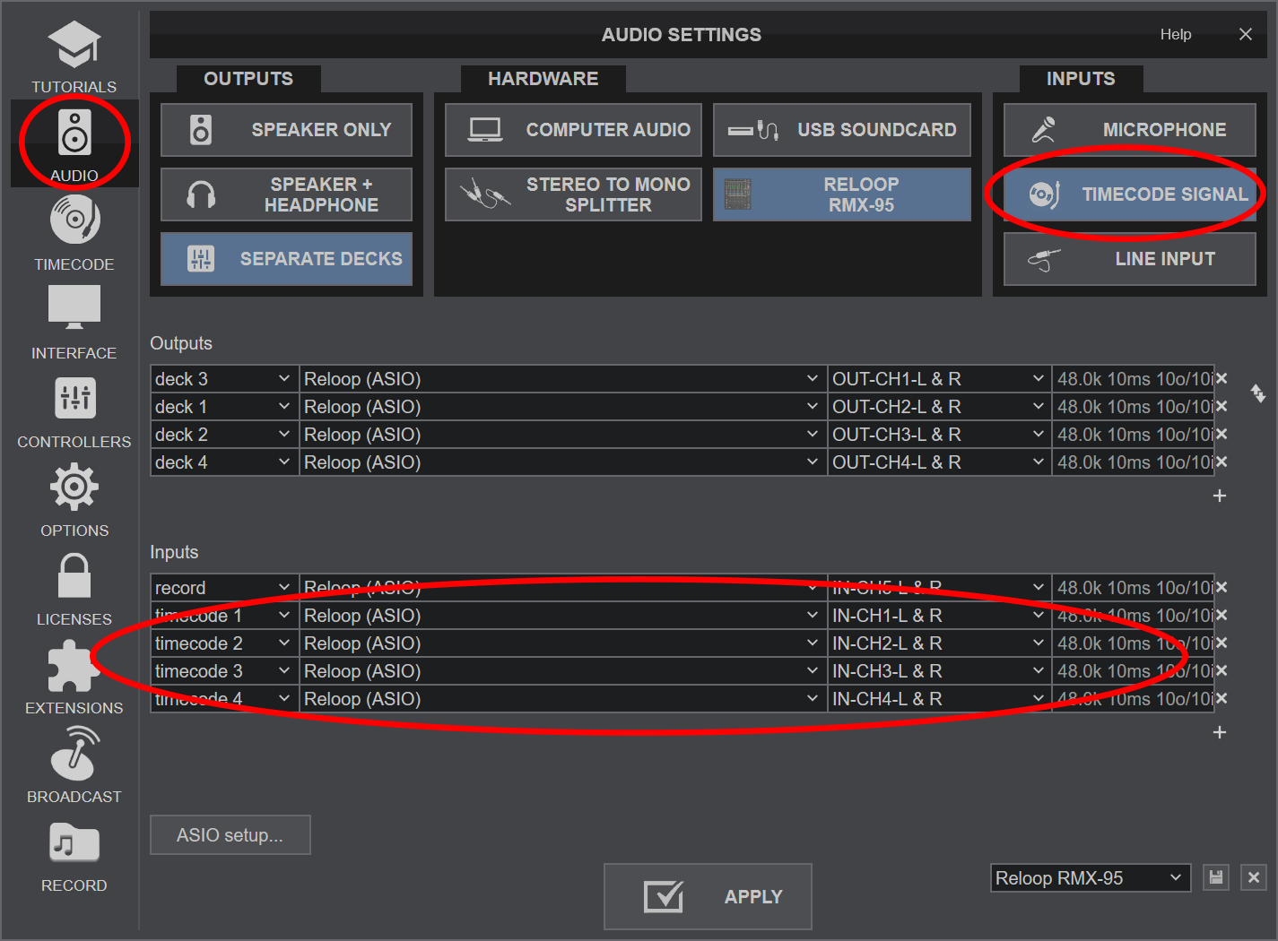

Timecode - DVS

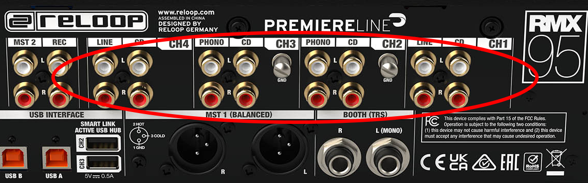

By default up to 4 Timecode inputs can offer DVS control to 4 VirtualDJ Decks, using CH Inputs 1 to 4. Read further information for Timecode Inputs at VirtualDJ Manual
  • Depending on the DVS/Timecode device type (Turntable-Vinyl or CD), connect your Timecode device to the LINE or PHONO inputs at the rear panel of the RMX-95
    Reloop RMX-95 - Rear panel - Timecode Inputs
  • Open VirtualDJ Settings and select the AUDIO tab.
  • Click on the Timecode SIGNAL button at the top-right and VirtualDJ will add the necessary inputs in sound setup. You can remove or add extra inputs if required (e.g use only 2 of them if you are using just 2 Timecode inputs)
  • Click APPLY.
VirtualDJ Audio Setup with 4 Timecode inputs
