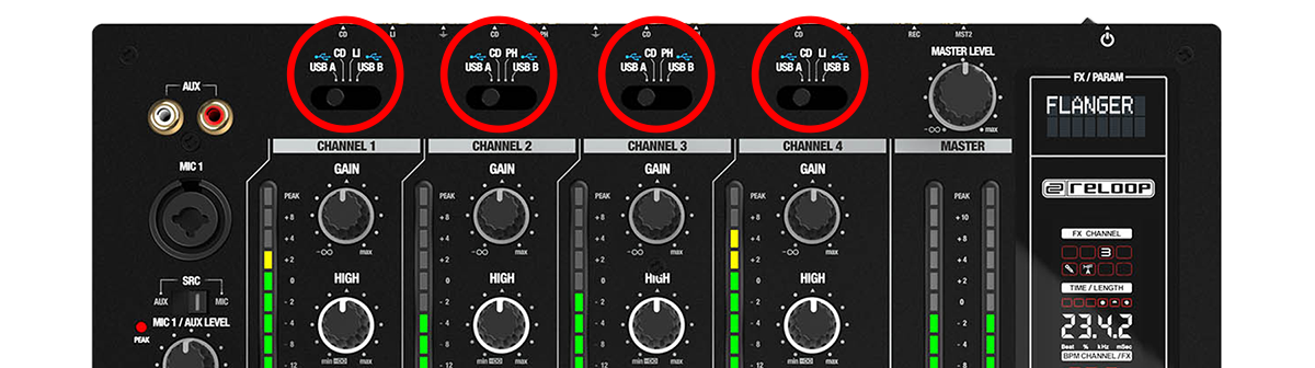

SOURCE SELECT
Make sure all the Mixer Channels are set to USB A or B source (depending on the USB port of the RMX-95 you used to connect it with your computer) in order for VirtualDJ to receive and send Audio and MIDI functionalities.
If any of the Mixer Channels are not set to USB A/B source, then VirtualDJ will not be able to send or receive Audio and MIDI from those Channels.

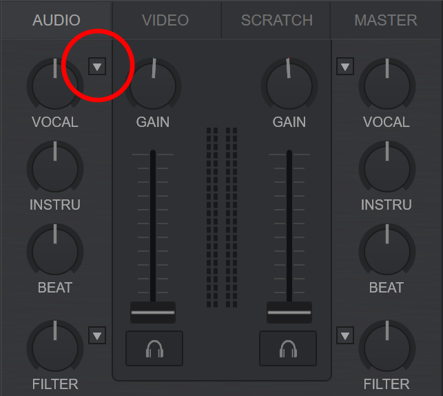

The unit doesn't offer a dedicated button to allow switching between modes.
You can use VirtualDJ GUI to select your desired mode of operation.

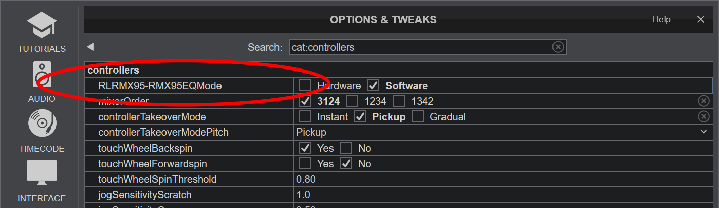

Switching EQ Modes
You can switch EQ Mode by opening VirtualDJ config, clicking the Options tab and then the Controller icon.
You can now change the RLRMX95-RMX95EQMode setting to select the desired mode of operation.
