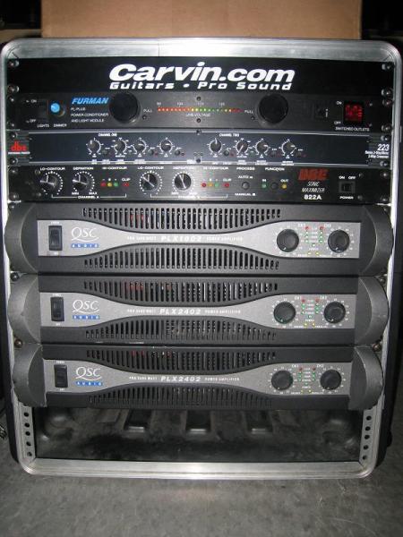

There are different ways to hook up subwoofers. I just keep it simple.. I am using two Jbl Mpro 418s subwoofers 600 watts rms & 2400 watts peak. It has a 135 db max spl. The subs are 4 ohms. I am using a QSC plx 3002 amp that pushes 900 watts per channel in 4 ohms regular. I am using a DBX 2/3 way crossover to separate my tops and subs. It sounds really good. My speakers push 400 watts rms in 8ohms so im using a QSC plx 2402. The 2402 pushes 425 watts rms in 8 ohms. I could use another amp that pushes alitlle more watts for the tops but it sounds good enough alrteady.

@ Hippy. The tops are Carvin Pm15. They are 400 watts rms, 800 watts peak. 100db spl. The JBL subwoofer can take alittle more from a more powerful amp more like 1,100 watts rms per channle but 900 watts sounds good. Before i had another qsc plx 2402 for the subs but i sold it to buy the 3002. I was lucky to buy the 3002 for 400 bucks.
The 2402 for the Tops & The 3002 for Subs.
