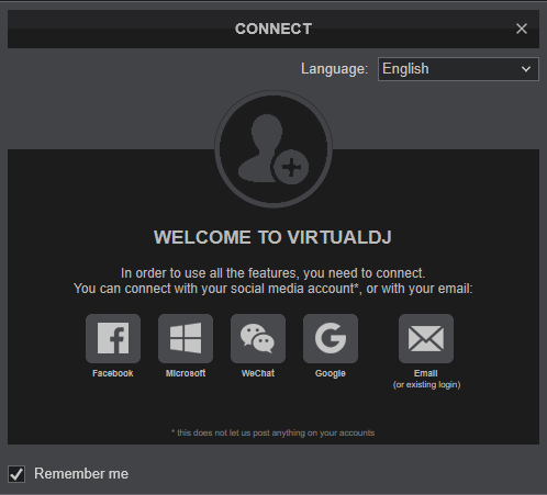

Once VirtualDJ is opened, a Connect Window will appear. Login with your Account’s credentials.
A Pro Infinity, a Pro Subscription or a Home Plus License is required to use the Traktor Kontrol Mx2. Without any of these Licenses, the controller will operate for 10 minutes each time you restart VirtualDJ.
https://virtualdj.com/buy/

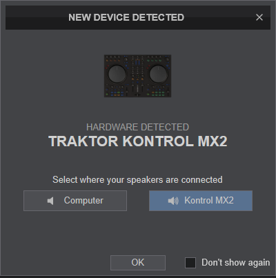

Select the Kontrol MX2 button in order VirtualDJ to apply the pre-defined audio configuration (speakers need to be connected to the rear side of the device in this case), or Computer if you don't have any speakers to connect to the Kontrol MX2 and need to output sound from the default sound card of your computer.
Click to OK
The device is now ready to operate.

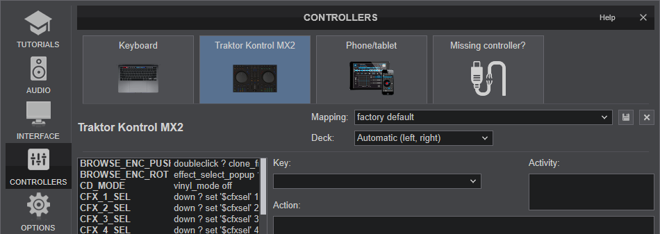

MIDI Operation
The device should be visible in the CONTROLLERS tab of VirtualDJ Settings and the “factory default” available/selected from the Mappings drop-down list.
Find more details at https://virtualdj.com/wiki/VDJ8script.html

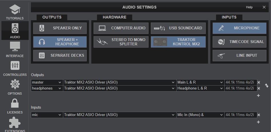

AUDIO Setup
The device has a pre-defined Audio setup and a special button in the AUDIO tab of VirtualDJ Settings to provide that.
For further software settings please refer to the User Guide of VirtualDJ.
