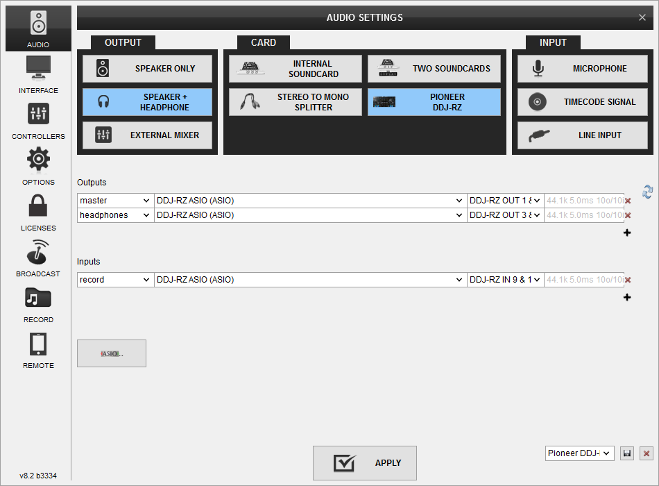

A detection window will appear next verifying proper connection with the DDJ-RZ.
Click on the "Use Soundcard" button in order VirtualDJ to apply the pre-defined audio configuration. Keep in mind that due to the nature of the unit, speakers need to be connected to the Master Output of the DDJ-RZ and the pre-defined audio configuration to be used.
Click to OK.

The unit has a pre-defined Audio setup and a special button in the AUDIO tab of Config to provide that. Alternative Audio setups can be applied in the same window.

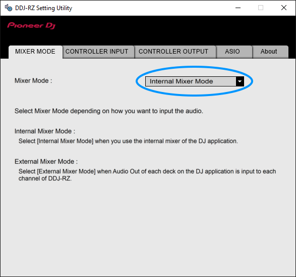

Please note that the unit offers two different modes for it's audio routing.
VirtualDJ uses the default audio routing provided by the device which is "Internal Mixer Mode". Please use Pioneer's "DDJ-RZ Setting Uitlity" application to make sure that the audio routing of the device is set to the correct mode prior operating this unit.
