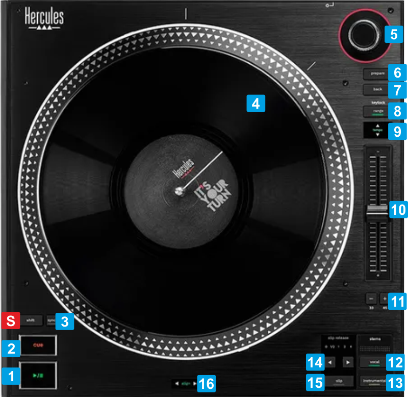

Deck Controls
S SHIFT
Press this button down to access secondary actions as described in the SHIFT ACTION column
KEY
ACTION
SHIFT (SECONDARY) ACTION
1 PLAY
Play/Pause the track loaded to left/right deck
Play-stutter track. When pressed, track will resume playing from the previously stopped position
2 Cue
Sets current position as Temporary Cue point.
Preview track when paused while button is pressed
Jumps and stops to the Cue point when playing
Returns to the beginning of the track
3 SYNC
Match BPM and Beat Phase with the opposite deck
Smooth pitch reset. When pressed track will gradually get its original tempo
4 JOGWHEEL
Motorized jogwheel for scratching or bending.
5 BROWSE
Browse through Tracks or Folders depending on the currently focused list of Browser.
If focus is on Folders, push to set focus to Songs List. If not on Folders List, push to load the selected Track to the Left/Right Deck. Double-push to clone the Track of the opposite Deck to the Left/Right Deck
Scrolls fast (+10/-10 per step) through Folders or Tracks
6 PREPARE
Adds the selected Track(s) from the Songs list to the Automix list
Sets the focus of the Browser to the Sideview list
7 BACK
Toggles the focus of the Browser between the Folders and the Songs list.
Selects the next available tab of the Sideview list of Browser
8 RANGE
Selects the next available %range for the Pitch fader
Enable/disable Key-Lock
9 TEMPO LED
The LED indicates if the Track's tempo matches the value of the opposite Deck and will be offered if the BeatMatch Guide button [24] is turned on. When enabled, the red LEDs indicate the direction the Tempo fader needs to be moved in order the track to get the same BPM as the one of the opposite Deck
10 TEMPO
Adjust the tempo of the loaded track
11 PITCH BEND
Speed up or speed down the tempo of the playing Track while these buttons are held down. When released, the Track will continue playing at the speed designated by the Pitch fader.
Use the [+] button to set the motor speed to 45 RPM, and the [-] to set back to 33 RPM (default)
12 VOCAL
Press to keep the Vocals Stem and mute the Instrumental Stem of the loaded Track
Enable Slip & FXs on Vocals. When enabled, scratching and Effects will be applied to just the Vocals Stem of the Track
13 INSTRUM
Press to keep the Instrumental Stem and mute the Vocal Stem of the loaded Track
Enable Slip & FXs on Instrumental. When enabled, scratching and Effects will be applied to just the Instrumental Stem of the Track
14 SLIP BEATS
Selects the previous/next available beats value for Slip Release. When Slip is enabled, and Beats value is not on 0 (default), a delay in resuming Track will be applied after Slip has finished applying scratching, Loops , hotcues etc.
15 SLIP
Enable/disable Slip mode. When enabled (its led is turned on) several functions, such as scratching, Loops and hotcues will be performed temporary and when finished (released), the track will resume from the position it would have been if the action was never triggered.
Enable/disable Quantize. When enabled, Loops , Hotcues and other functions will be snapped to the nearest Beat
16 BEAT ALIGN
These leds indicate the direction the jogwheel needs to be moved to, in order its beat-grid to match with the opposite deck. Leds will operate if:
- the BeatMatch Guide button [24] is turned on
- the Deck is not the Master -Deck (deck that is playing out live - on air)
- the deck is not playing
