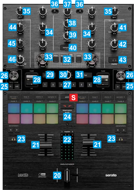

Mixer & EFFECTS CONTROLS
KEY
ACTION
20 CROSSFADER
When on far left position, only sound from the left deck will be heard from the Master Output. When at far right position, only the sound of the right deck will be heard from the Master Output. In all other positions, the audio signals from left/right decks will be blend.
21 VOLUME
Adjust the Volume of the Left/Right deck
22 VU METERS
The left and right-side series of leds indicate the pre-fader output level of Left/Right Deck,. The 2 middle series of leds indicate the output level of the Master Output assuming the Master Out channels of the T10 are used as Master in VirtualDJ Audio Setup..
23 PFL
Use these buttons to send the pre-fader audio signal of the Left/Right deck to the Headphones channel for pre-listening (connection at the front side).
Hold SHIFT and then use these buttons to toggle Mixer EQ knobs between Frequency and Stems mode. When a Mixer Channel (Deck) is set to Stems , the led of the PFL button will blink when SHIFT is pressed. Read more at https://virtualdj.com/manuals/virtualdj/interface/mixer/audio.html
24 BEATMATCH GUIDE
When enabled, several assistant leds on the Decks will guide you for a perfect beat-match
25 Loop IN/OUT
Loop IN
When not in Loop , press to set current position as the beginning of a manual Loop . Press and hold this button for more than 1 second to turn a 4 beats auto- Loop on/off. When in Loop , press to set the Platter to Loop In Adjust mode and then use the platter to fine-adjust the Loop In position.
Loop OUT
When not in Loop , press to set current position as the end of a manual Loop .
When in Loop , press to set the Platter to Loop Out Adjust mode and then use the platter to fine-adjust the Loop Out position.
26 Loop ENC
Turn to half/double the size of the Loop . Push to turn the Loop on/off.
If in Loop , turn to move the Loop backwards/forward in time by the amount of the selected beats of the Loop . When not in Loop skip the Track by the same amount backwards/forward
27 FX ARM
These represent 6 FX Slots in VirtualDJ. When any of these buttons are enabled, the Effect selected to FX slots will be armed and then can be applied to the Left/Right Decks with the FX ON paddles. The Effects of the FX Slots can be selected from the GUI of VirtualDJ
The selection can be "single" (default) or "multi. See the availble setting at T10-Settings
28 FX ON PADDLE
Hold down (temporary) or push up (toggle) to apply the armed FX slots to the Left/Right Decks
29 FX BEATS
Increase/decrease the amount of Beats (usually the 2nd Parameter) of the armed Effect slots.
30 FX DEPTH
Adjust the 1st Parameter (usually the Wet/Dry) of the armed Effect Slots
31 FX TAP
Not used in VirtualDJ Mapping
32 FILTER
Use these 4 buttons to select one of the pre-assigned Color FXs (High/Low-Pass Filter by default) for Left/Right deck, and then use the FILTER knob [33] to apply.
33 FILTER
Apply the selected Color FX (High/Low-Pass Filter by default) to Left/Right deck. No ColorFX is applied (off) when the knob is at the center/middle position.
34 EQ HIGH/MID/LOW
3-Band Equalizer. Use these knobs to cut/boost the frequencies of the Low(Bass) / Mid (Middle)/ High (Treble) Equalizer Band or the Stems Levels depending on the selected EQ mode.
35 GAIN
Use these knobs to adjust the pre-fader output level of the Left/Right deck When the knob is at the middle/center position, the track will be at zero dB level (or any other value set in VirtualDJ Options)
36 USB SOURCE
Set the switcher to either A or B position depending on the rear-panel USB connection to control the VirtualDJ Decks on a computer. When set to the other USB Source, the Decks on the current USB source will display "MUTE (IN USE)"
37 * Master VOL
Adjust the level of the Master Output (connection at the rear panel).
38 * BOOTH VOL
Adjust the level of the Booth Output (connection at the rear panel). Note that the Booth Output is not part of the USB Audio Interface, so caanot be added to the Audio Setup of VirtualDJ as it is a copy of the hardware Master Output with its own dedicated level.
39 SAMPLER VOL
Adjust the level of the VirtualDJ Sampler output.
40 SAMPLER FX
When enabled, the Armed FX Slots will apply to the Sampler Output, using either of the FX Paddles
41 * HEADPHONES MIX
Blends the signal from the Deck or Master PFL and the Master Output in Headphones.
42 * HEADPHONES VOL
Adjusts the level of the Headphones Output (connection at the front panel).
43 * Master PFL
Sends the audio signal from the Master Output to the Headphones channel. Hardware operation, not visible in GUI or controlled from VirtualDJ
44 ** AUX VOL
Adjusts the level of the Aux Input (connection at the rear panel).
45 ** MIC VOL
Adjusts the level of the Microphone Input (connection at the rear panel).
46 ** MIC TONE
Adjusts the Tone level of the Microphone Input (connection at the rear panel).
