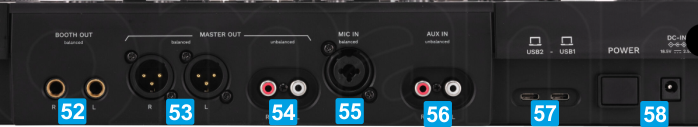

Hercules DJControl T10- Rear panel
52 BOOTH OUT
This socket lets you connect monitor speakers using 2 x balanced ¼” / 6.3 mm jack. The signal played on the Booth output is the same as that sent to the Master output, but its volume is different because it is controlled by the BOOTH volume knob at the top panel.
53 Master OUT
This socket lets you connect speakers for the audience using 2 x balanced XLR. The level of this output is controlled by the Master VOL knob at the top panel
54 Master OUT
Secondary Unbalanced Master Output. Connect your amplifier or amplified speakers using RCA cables
55 MIC IN
Use this socket to connect a mono dynamicMicrophone using connect a mono dynamic microphone XLR / ¼” / 6.3 mm jack combo connector.
56 AUX IN
Use this socket to connect an analog stereo source at line level (CD player, MP3 player, etc.). using 2 x unbalanced stereo RCA..
57 USB-C
Connect the controller to one or two computers at the same time.
58 POWER ON/DC
Connect the power cable and plug the DJControl T10 controller into an electrical outlet using the adapter.
Push to power on Inpulse T7 after all connections are done.
