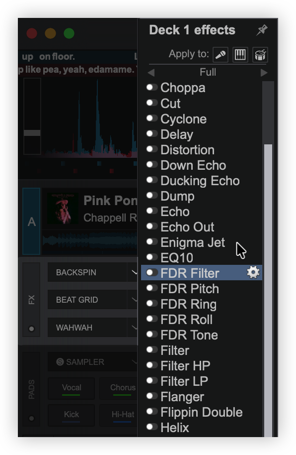

Once the Effect select button is pressed, an Effects Selection list will be displayed to easily scroll through all the available Sound and Video Effects to make your selection. The Full Effects Group is displayed by default, clicking the left and right icons on either side of the FX List will rotate through Full, Pioneer, Rane, Legacy, Default, and Video FX lists.
Click on the Pin icon to the right of Sound Effects to keep the Effect Selection list visible (pinned) after effect selection if required.
Once the Effect is selected it can be activated by clicking on the effect name in the Deck Effect Panel or in the Effect Selection List by clicking on the Activate Button to the left of the desired effect.
Multiple effects can be triggered from the Effect Selection list simultaneously regardless of the number of Effects visible in the Deck Effect Panel.
Clicking on the button in the Deck Effect Panel (if available) or the gear icon to the right of each effect in the Effect Selection List will open the GUI for the desired Effect and dock it to the lower right of the software interface beside the Info Panel.

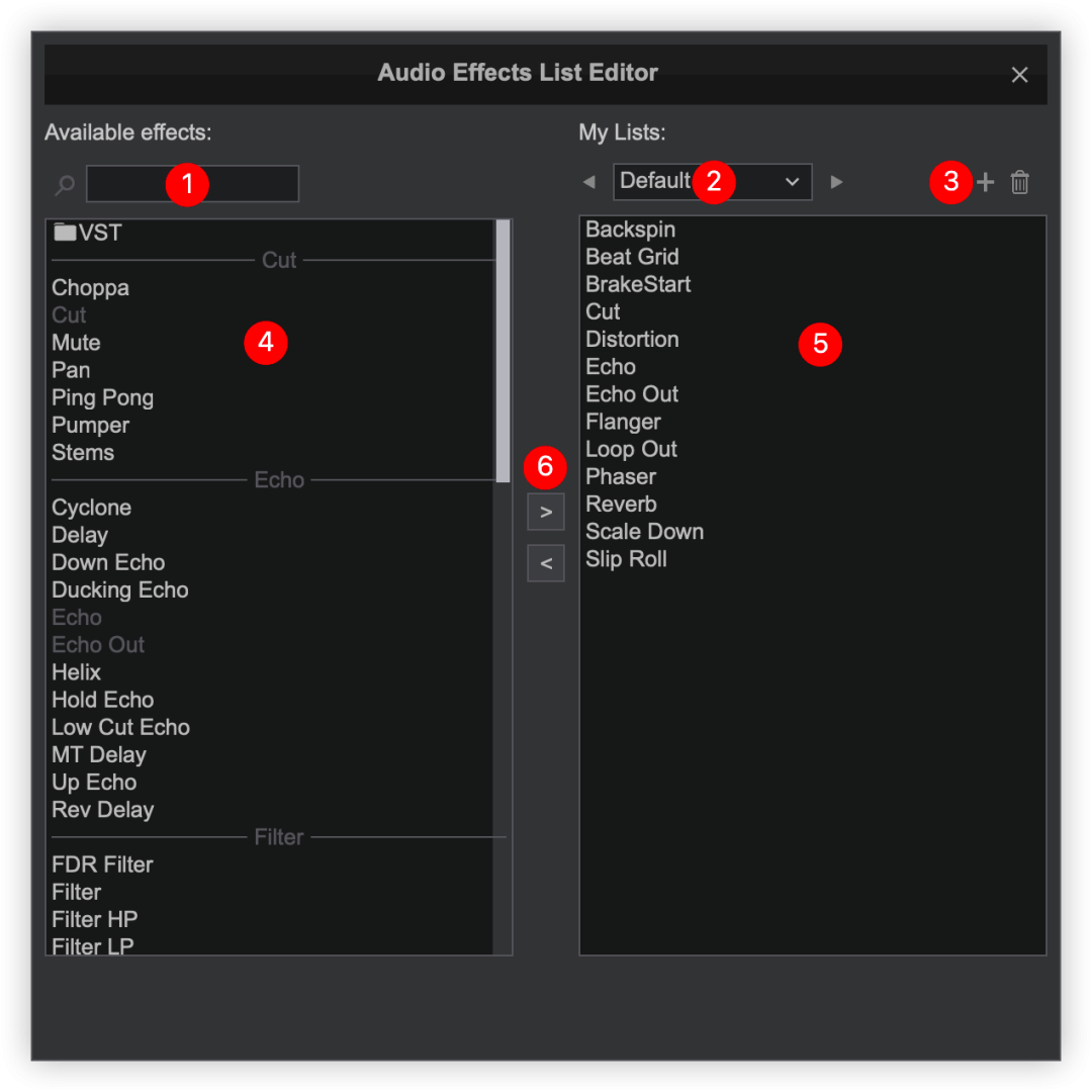

VirtualDJ offers the ability to organize all effects into lists for easier access using the Audio Effects List Editor .

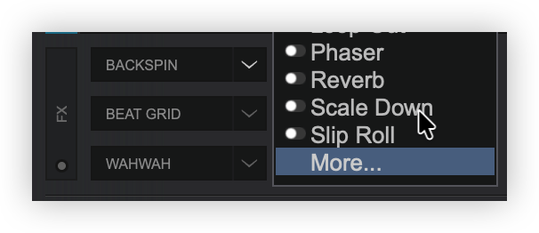

Scroll to the bottom of the Effects List and click on More... or Manage... (depending on the list displayed) to open the Editor .
The Audio Effects List Editor will open to add and remove effects in the available lists, create new lists, and/or delete lists.
  1. EFFECT SEARCH BAR. Searches available effects to quickly add to the current list.
  2. CURRENT LIST. Displays the current list being edited. Clicking the left and right arrows will cycle through the available effects lists. Selecting the dropdown arrow will display all lists with the option for New... which will create an empty list.
  3. LIST ADD/REMOVE. Clicking on the button will create a new empty list. Clicking the trashcan will ask to delete the current list. Clicking YES will delete the list only and not the effects.
  4. AVAILABLE EFFECTS. Displays all available effects categorized by style. When using the Effect Search Bar, the effects that do not match the search query will disappear. Effects that are white are available to add to the current list while effects that are greyed out are already in the list being edited.
  5. CURRENT EFFECTS. Displays the effects that are in the current list. Effects in this list can be dragged and dropped to re-order the list based on user preference.
  6. EFFECT ADD/REMOVE. Clicking on an effect from the Available Effects list and then clicking on the button will add it to the current effect list. Clicking on an effect from the current list and clicking on the button will remove it from the current list and add it back to the available effects list.
