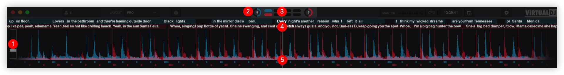

This area tracks the waveform of each song loaded or playing on a deck. It also features a Computerized Beat Grid (CBG) used for visual mixing and beat-matching. A Lyric-Assisted Overlay is also provided to help set Cue points, create fun word-play between tracks, or create instant karaoke on the fly.
  1. ZOOM SLIDER (Pro and Performance Layouts). Use the slider to zoom in/out and adjust the visible area of the wave in the waveform.
  2. PHRASE INDICATOR (Pro Layout Option). Indicates on which beat of the 16 beat phrase the track is on. This can be turned on or off in the Layout Menu under Beat Counter
  3. BEAT KEEPER. Indicates on which beat of the 4 beat bar the track is on.
  4. LYRICS OVERLAY. Displays the lyrics of the track while using Stems 2.0 (when available) in relation to the waveform. Lyrics can be edited in the Lyrics Editor or optionally turned off by going to Settings Options showLyrics and selecting No.

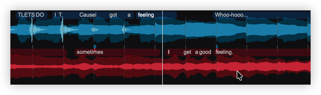

    Beats Waveform

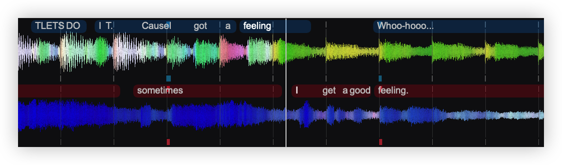

    Colors Waveform

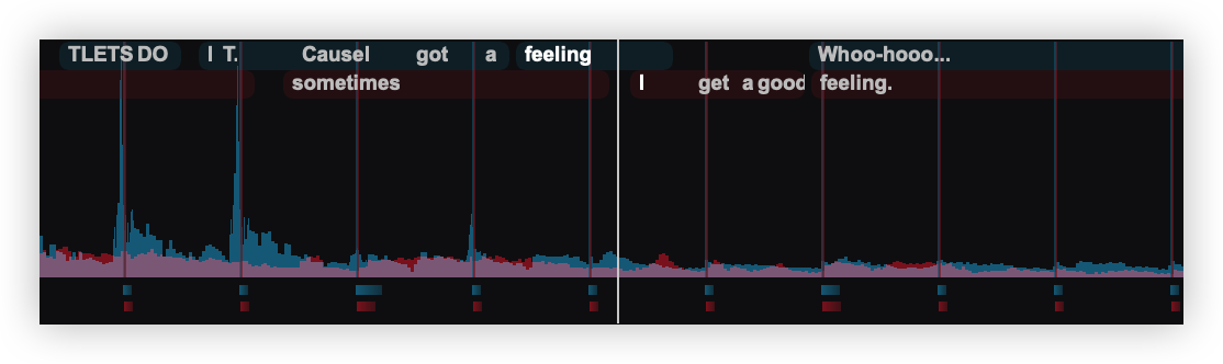

    Shapes Waveform
  5. RHYTHM WAVE & CBG. This waveform provides a visual representation of the audio curves and peaks corresponding to the rate/rhythm of the music. The peaks in the waveform represent the beat of the music and are used to help synchronize multiple tracks together by matching (overlapping) the peaks to occur at the same time.
    The current position of the track (present) is represented by the position marker (white line) in the middle of the screen. As the track plays, the waveform scrolls from the right to the left travelling over the position marker. Everything to the left has already been played (past) and everything on the right represents what has yet to be played (future).
    Below the waveform there are small blocks named CBG (Computerized Beat Grid), which represent the position of measures. The large blocks represent the beginning of a measure (4:4 time). The CBG of a track is used for synchronization of samples, effects, autosync features and anything else in the VirtualDJ that uses the track’s beat to determine position or timing. The CBG can be altered or adjusted by using the Tap Button, the POI Editor or the BPM Editor .
