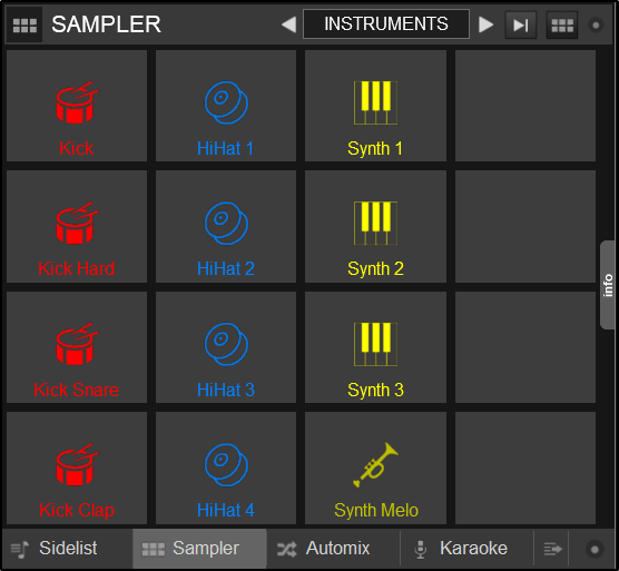

Sampler Pad View
Sampler List View

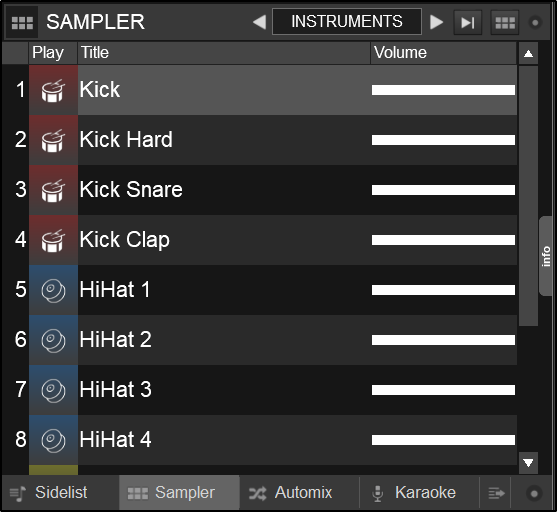

The Sampler view of the Sideview offers 2 different views; a Trigger Pad and a List View. The Trigger Pad view offers large buttons (pads) to trigger a Sample, with an icon, the name and a progress bar. The List view also offers all possible information (Volume, Group name, Mode, Color, etc). You may also choose which fields you wish to see in the List View by right-clicking on the header. Click on a Sampler Pad or use the Play field in List view to trigger/play/stop a Sample.
The view can be toggled by pressing the view display button.

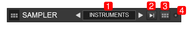

  1. SAMPLE BANK. The Sampler can have unlimited banks and each bank can have up to 64 samples. Use the arrow buttons to navigate through the available banks or click inside the name box to get a list with all the available banks. Choose New... from the menu to create a new Bank. Sampler banks can be renamed and deleted from the Sampler folder in the Folder List by right-clicking on the desired bank.
  2. TRIGGER MODE. Click on the Trigger Mode button to toggle through one of the available Trigger Modes. Trigger Mode is a global selection (applies to all Banks). However a Group can have its own trigger mode (see Sample Editor )
    On/Off
    Press a Sampler Pad to start playing a sample from the beginning. Press the same Sample pad again to stop the sample.
    Hold
    The Sample will play from the beginning as long as the Sampler Pad is pressed.
    Stutter
    The Sample will play from the beginning, each time you trigger a Sampler Pad. Right-click to stop the Sample
    Unmute
    The Sample will be muted if the Sampler Pad is not pressed. Right-click to stop the Sample.
  3. VIEW DISPLAY. Toggles between Pad View and List View
  4. SAMPLER OPTIONS. The Sampler Options menu includes settings to customize how the sampler behaves:

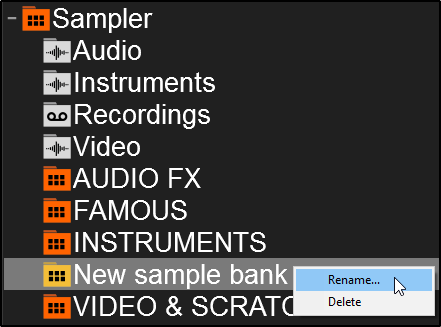

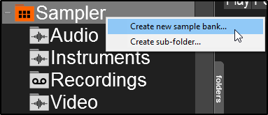

  1. Navigate to the Folder list and locate the Sampler folder.
    Right-click on the folder and select Create new sample bank...

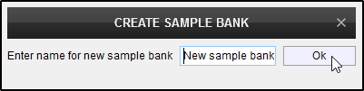

  2. A pop-up box will appear to give the new sample bank a name. Type in the preferred name for the bank and click OK or press enter on your keyboard.
  3. Once the new sample bank is created it will appear in the Sampler folder in alphabetical order.
    Banks can be reordered by dragging and dropping up or down the Sampler folder list.
    Right-clicking on the sample bank will give the options to Set active, Rename..., Delete, Open in Explorer, and Properties.

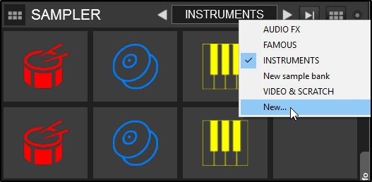

Additionally, a sample bank can also be created from the Sampler Sideview or the deck's Sampler Pads. Right-clicking on the Sample Bank text will display all available banks and provide the option for New...
Clicking this option will instantly create a bank (without the option to name it) for on the fly convenience and will be stored in the Sampler folder list as New bank. The bank can later be renamed or deleted by using the above steps.
