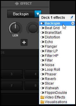

Clicking on the effect name will trigger the desired effect, while clicking the dropdown arrow will open the FX menu providing the ability to select one of the many other effects available.

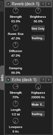

Click on the Pin icon to the right of Sound Effects to keep the Effect Selection list visible (pinned) after effect selection if required.
Once the Effect is selected it can be activated by clicking on the effect name in the Deck Effect Panel or in the Effect Selection List by clicking on the Activate Button to the left of the desired effect.
Multiple effects can be triggered from the Effect Selection list simultaneously regardless of the number of Effects visible in the Deck Effect Panel.
The Effect can then be unpinned by using the Pin icon on top of the Effect GUI so that it can be re-positioned to anywhere on the screen for greater customization and ease of use. Clicking on the X will close the Effect GUI regardless of it’s position but will not deactivate the effect.

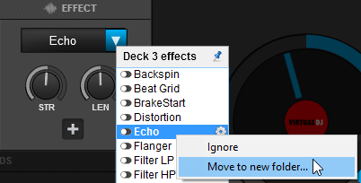

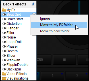

Additionally, effects can be set to Ignore if not being used. Clicking on Ignore will create a new Group (folder) and remove the selected effect from the main drop-down menu. All ignored effects will be placed into the ignore folder.
The Ignore Folder is particularly useful for controller use. While scrolling through effects, any effect that is placed into the Ignore Folder will not be displayed in the effect selection slots on the interface.

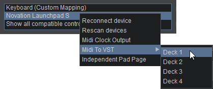

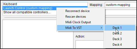

VST Effects usually provide their own GUI. Use the + button from the skin or the settings icon from the Effects List, to get a floating window with the effect’s interface.
This setup is pass through. Mapping for the device is handled by the selected VST (if offered).
