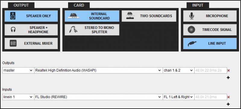

In VirtualDJ, ReWire is integrated into the advanced audio setup and is another input that can be routed to a VirtualDJ deck. Prior to enabling, a Line-In must be added first in the Audio Setup. This line input must be assigned to a ReWire slave application and then to a ReWire channel. The ReWire slave application can be selected in the soundcards drop down menu. A list of virtual ReWire channels will appear for this application the same way as the physical soundcard inputs do.
Once the Audio Setup is done, the source area will become available via toggle in the Custom Button's panel (Pro and Performance Layouts) and activating the Line-In button on the Interface for the ReWired deck will route the audio from the slave application to the VirtualDJ Mixer . The audio from the slave application is also routed to a VirtualDJ deck and can be mixed in real time with the other VirtualDJ decks. The Rewired deck(s) will display the slave application as a Line-In as well as the Beatgrid and the tempo (BPM) of the audio in real time.
