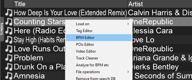

VirtualDJ has an advanced Sound Engine that will calculate the tempo (BPM value) and the Beat Grid (CBG) of your tracks with accuracy in almost all cases. In the rare case that either the BPM value or the Beat Grid of your track are not correct, the BPM Editor will provide all the tools to easily and accurately calculate and manually adjust them. To open the BPM Editor , right-click on any of your tracks or click on BPM on the decks of the Interface.

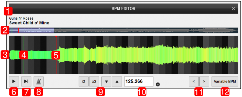

  1. FILE INFO. This area shows the Artist, Title and Remix (if entered) of the file being edited.
  2. SCROLL BAR. Displays the zoom level of the waveform (highlighted in blue) and can be dragged to any part of the file to perform precise adjustments.
  3. WAVEFORM. Provides a visual display of the audio information. It displays the beatgrid using the grayscaled background and can be zoomed in to make precise BPM adjustments with a wheel mouse.
  4. PLAYHEAD. Shows the current position of the track. All new adjustments and play functions use the playhead to determine the start position. It can be clicked and dragged to any part of the track with a mouse.
  5. BEATGRID ANCHOR. The first detected beat as analyzed by VirtualDJ. It can be grabbed with the mouse to adjust it’s position. The Computer Beat Grid (CBG) is locked into place (non-adjustable) to the left of the anchor. Adjustments to the CBG can only happen to the right of an anchor.
  6. PLAY/STOP. Will play the track if it is stopped and will stop the track if it’s playing.
  7. PLAY-HOLD. Plays the track as long as the button is held. Once released, the playhead will jump back to it’s previously stopped position.
  8. METRONOME. Will play an audible beat based on the set BPM to verify that adjustments are correct and precise. The volume of the Metronome can be adjusted from the Options.
  9. BPM ADJUSTMENTS. Use these buttons to make major or fine adjustments. Use the /2 and x2 buttons to half or double the displayed BPM and use the up and down arrows to make small BPM adjustments.
  10. BPM VALUE & OPTIONS. Displays the currently adjusted BPM. The small button to the right provides the the following options:

  11. BPM SHIFT. Use the left and right arrows to shift the BPM 1 beat backwards or forward.
  12. VARIABLE BPM. For tracks that have a tempo change, this button is used to add and remove additional beat anchors. Once clicked, the display will change to provide these options.
  13. TAP. Click the Tap button to manually calculate the BPM of the track by tapping to the beat 4 times.

  1. From the File list, right-click on the file to be edited and select BPM Editor from the option menu that appears.
